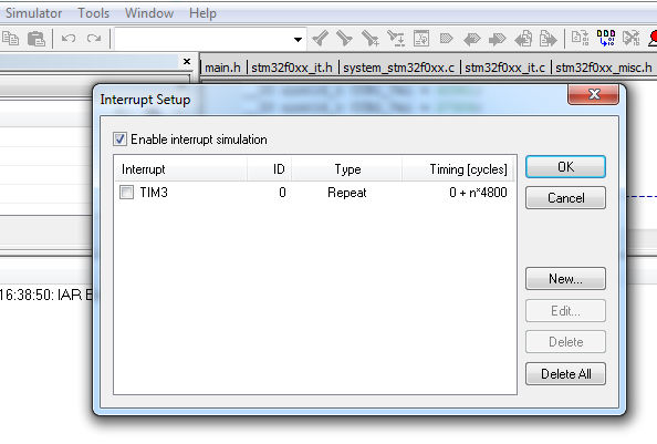

I have made a code that initialize a timer of an STM32F0 to tick every 1 ms and generate an update interrupt , and i want to test if my code work correctly
My questions:
1- The IAR startup file should be Added to my project ?
2- what is the right config to be done to simulate my code ?
2- The interrupt simulation should be enabled ?
Thank you

2016-12-28 7:43 AM
Thank you for your reply
I am using STM32F051 , how can i verify that the simulator support it ?
I use a Timer to generate an interrupt every 1 ms
Is it necessary to enable
interrupt simulation to test if the interrupt occure in the exact time ( after 1ms)
2016-12-28 9:02 AM
I typically use Keil, not IAR. You could review the documentation, or speak to IAR Support staff.
I'd expect you need to check that box, and the one for TIM3, and also write code as you would on real hardware, otherwise there seems little point in having a 'simulator'. The simulator needs to reflect exactly what real hardware would do.
What would work on real hardware
// STM32 TIM3 1KHz (1ms) Update STM32F0-Discovery - sourcer32@gmail.com

2016-12-28 12:02 PM
I have exactly the same code.
what I did not understand , if i check the box to enable interrupt simulation of the Timer it looks that the timer initialization have no effect ( because with it and without it the interrupt works correctly)
If i uncheck the box the interrupt don't work
2016-12-28 1:31 PM
I'm sure IAR has some supporting documentation for the simulator, I'm not here to argue its function or usability, I'm sure it is not a gate-level / clock accurate model.
