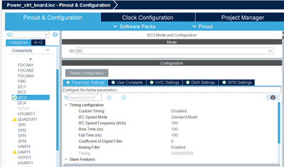

I’m currently working with an STM32G4 MCU and the BQ7697202 BMS IC, and I’m trying to establish basic I2C communication between the two. According to the BMS IC datasheet, I’ve configured the I2C address correctly, but I’m still unable to detect the IC on the bus.
Additionally, I implemented an I2C scan to search for available devices, but the scan returns “No device found.” Please find the attached I2C configurations for the reference.
