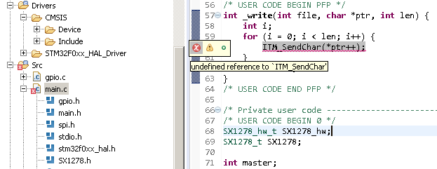

I 'm building my project but I get this error:
Undefined referrence to 'ITM_SendChar'.

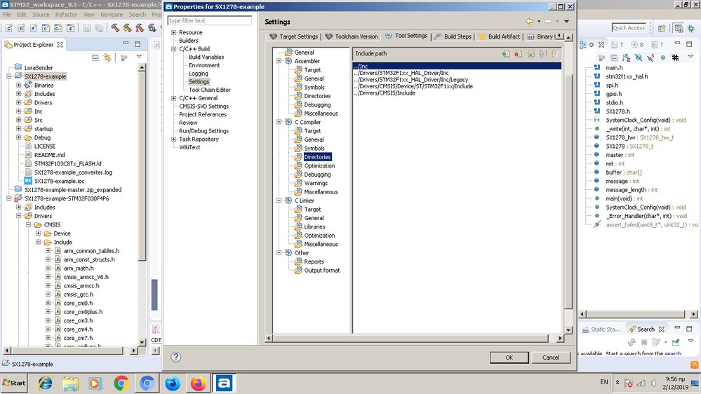

In the second photo you can see that the folder that contains the file (core_cm3.h) that contains the 'ITM_SendChar' function is included in my project.
(Properties->C++->BuildSettings->ToolSetings->C Compiler->Directories->Include Path)
