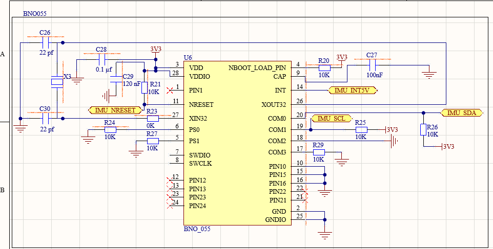

I am working on my custom PCB and trying to get serial output from a BNO055 (via I2C) and a SEN0257 (analog sensor).
I can successfully upload and run SPI code for the SD card, and it works.
My servo motors also work fine with uploaded code.
However, when I try to use the BNO055, I shared the schematic and my code, I get no data on the serial monitor.
I checked my PCB: there is no short circuit on the MCU or sensor circuits.
On the I2C bus, I can measure 3.3V from the SCL and SDA pull-up resistors.
For reference, here is the code I’m using for the BNO055:
https://github.com/yzeybek/BNO055_TEST/blob/main/Core/Src/main.c

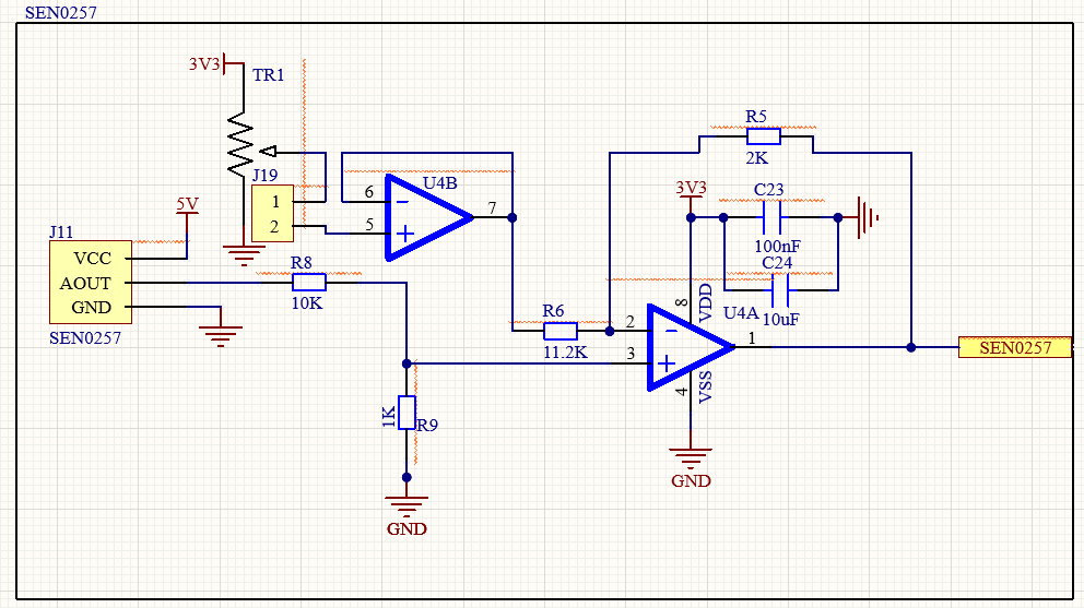

On the SEN0257, I can measure an analog voltage when the sensor is plugged in, but still no data appears on the serial monitor.
Here is the code for SEN0257:
https://github.com/yzeybek/SEN0257_TEST

I found the cause of the problem. The COM3 pin of the BNO wasn’t soldered properly and was left floating. Because of that, the I²C address was set to 0x40 which is the HID I²C address. After resoldering the pin, the issue was resolved. Thanks to everyone who helped.
2025-08-19 11:53 AM
can you share the schematics of the stm32 please ? I noticed that there is not shared.
If your project is not based on the github project that you shared, it could be a configuration issue with your I2C module.
Check first the your configuration.
When you are sure that the i2c module is correctly initiated, try to send a simple data on the bus. Do you have a digital analyzer to check of you can send data on the SDA ?
if you have no data, on the bus, deep into the BNO055. Perhaps a clock frequency is not set correctly (i didn’t checked the datasheet)
