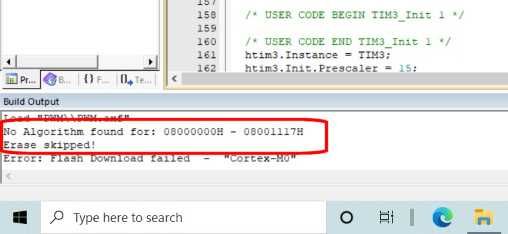

You need to pay attention to what it's telling you in the 'Build Output' window:
Note that you can copy & paste the text from that window - which is often more useful than a screenshot.
So your Flash Algorithm is not correctly configured; this is part of the Debug configuration in the Project options - though it should have been automatically set by the target chip selection
2021-03-19 4:51 AM
In project options go to debug settings and under the flash settings add in the STM32 part you are using.
2021-03-19 4:54 AM
