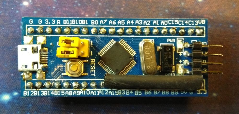

show us a picture of your board, is there a chance is an aliexpress bluepill?
2023-02-13 8:02 AM
I don't buy from AliExpress, but that doesn't mean its not a clone. I puchased it maybe a couple of years ago from eBay. Its been sat in a box of bits ever since. The black heat-shrink covers a resistor I added as per instructions to reduce the resistance down from 10k to 1.5k.

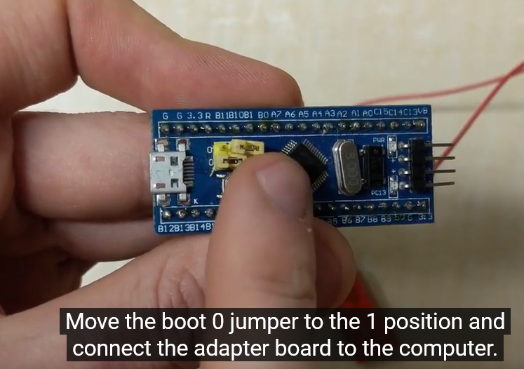

Just checking, did you move the corresponding jumper when flashing the arduino bootloader in your board?
https://www.youtube.com/watch?v=Myon8H111PQ

the 10k was wrong on all these boards, so 10-> 1k5 is right. is only needed for USB device working mode.

I just reviewed that video and I see there is a different URL for the library. I still had the library by Dan Brown installed. I have now updated the library. I have also tried the bootloader discussed in the video, but don't even get a /dev/ttyACM0 port with hid_generic_pc13.bin...
BTW, yes I am moving the jumper to the position shown before flashing.
