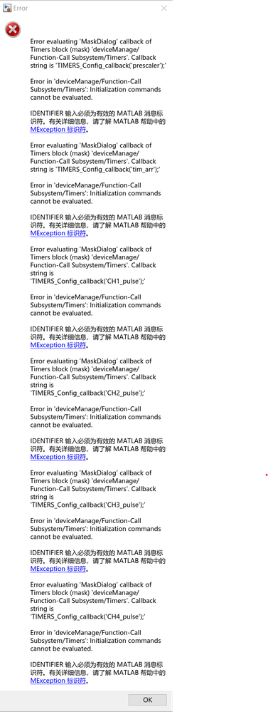

Hi, set stm32H750 tim, Error in 'deviceManage/Function-Call Subsystem/Timers': Initialization commands cannot be evaluated. TIMERS_Config function : Can not find which APB timer TIM1 is connected to.Default preference value STM32TIMAPB set to APB1 is used.

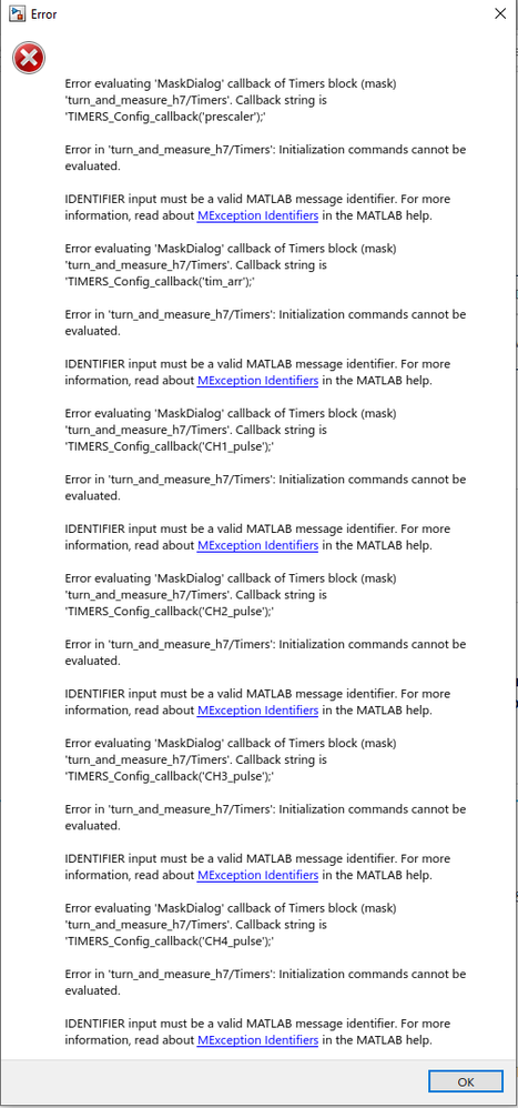

I have the same issues with the new release installed. I'm not able to configure and use Timers in my Simulink environment.
Like you can see I'm getting an infinite loop of this error and I need to abort Matlab.
I hope you can help me with this issue.

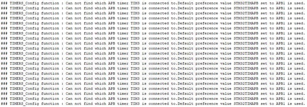

Thank you for your fast answer! Yeah I tried to load the example and it worked without a problem. What is really strange I think.
I executed the required commands and you can find the results in the attached log file.
Update: I tried to configure a second timer in the provided example and I got the same error like before. So I think there is just TIM1 which works properly.
