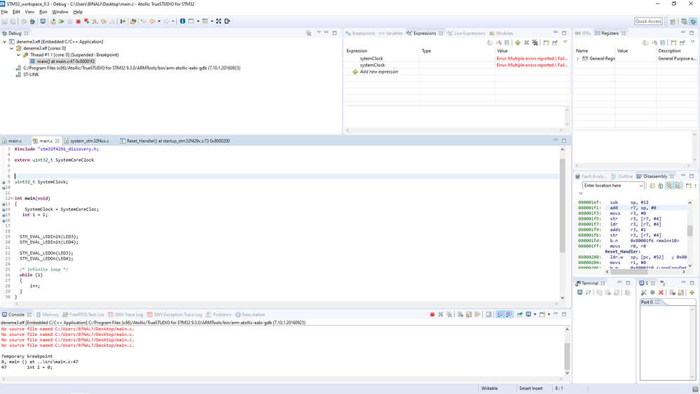

Can't find a source file at Can't find a source file at "C:\Users\B\335NAL\335\Atollic\TrueSTUDIO\STM32_workspace_9.3\deneme3\src\main.c"
Locate the file or edit the source lookup path to include its location.
The error I got in the compilation process is written above, the card I used is STM32F429I-DİSCOVERY development board.

Your username contains weird characters after B and L:
Move the project to a path that contains only ascii characters and no spaces.
-- pa
