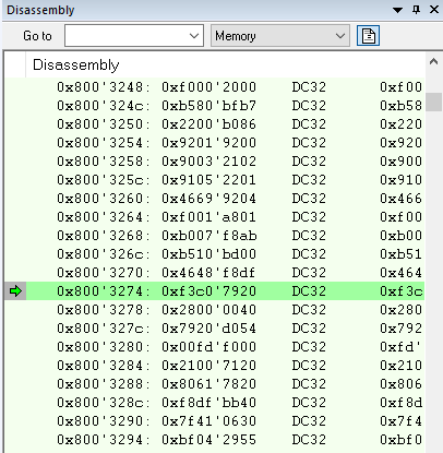

I also check the hex file and it looks like correct with bootloader bin @0x8000000 to 0x8003ffff and app start from 0x80040000 to the end.
When i run debug mode, and then click break, it stops at the address of bootloader part.(different addr. if i click run and break again)
what i expect is stop at main() off add as below figure(example from internet)
