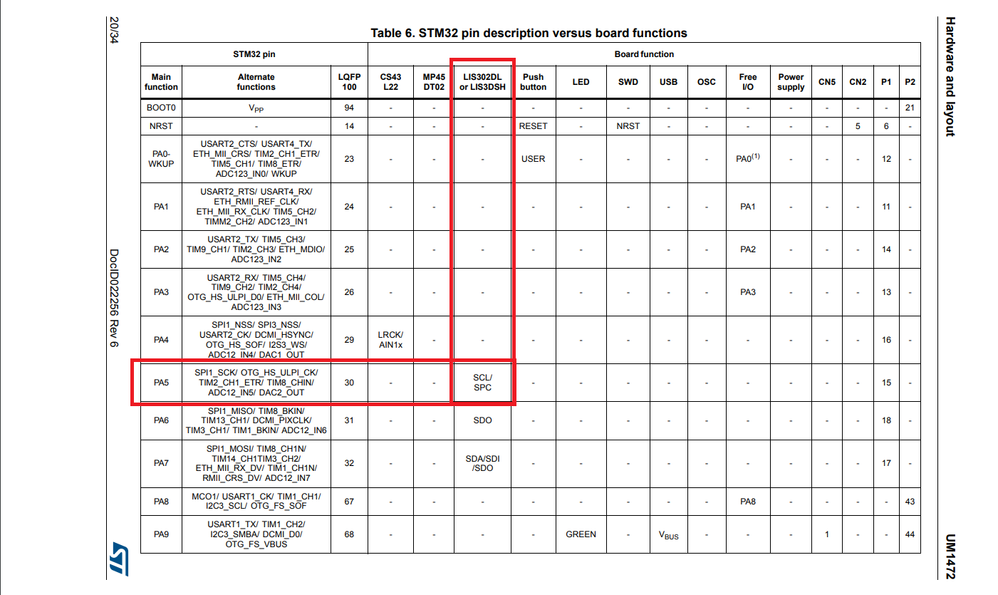

I found the ADC1 configuration in your .ioc file is PA5 pin so maybe this is cause your problem.
Because this pin is SCL/SPC pin for LIS302DL or LIS3DSH as the below picture.

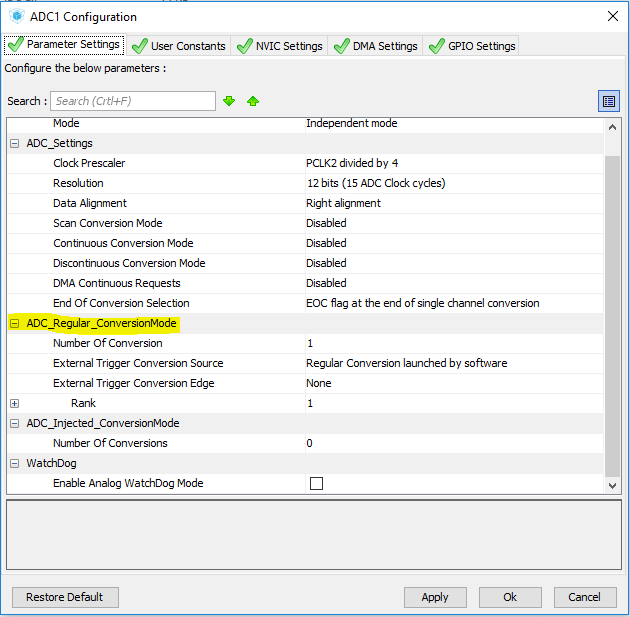

My recommendation is change to another pin such as ADC1_IN1(PA1 pin) and use default configuration in ADC_Regular_ConversionMode.
