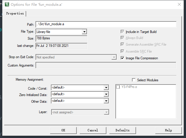

Hi, I have encountered the same problem. In my case the solution was as follows: when adding files with the extension .a to the Keil project, you must specify in their properties that this is a "Library file", not an "Assembly language file" (default).

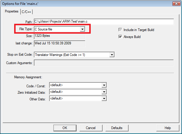

Hello @yjun.1 ,
@AKryl.1 is right. Keil is trying to preprocess the file (-E: run preprocessor) meaning that it considers it a source file. You can change how Keil interprets the file by right clicking on the file in the Project panel, clicking on Options for Fil 'filename' in the contexual menu, and changing the file type by selecting library in the File Type combo box.

2021-07-04 5:55 PM
You are right! I changed the File Type,now it works! no error! I worked this problem for 2 days in last week. thanks for your help!
