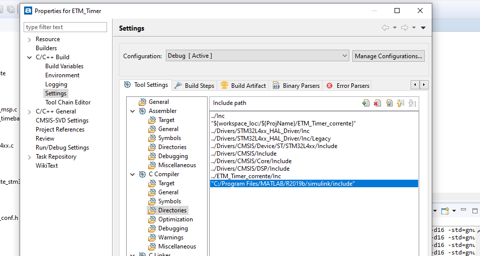

MMira.2
Associate II

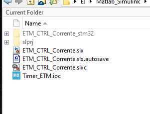

Now the Build Command in Simulink Model not generate all project file. Anyone have the same problem? This problem is present both Matlab 2019b 2020a
0693W000000Vvp8QAC.pngThanks Cyril,
This is the correct configuration in order to resolve de problem.
The problem recurs every time I generate new files from simulink. Is there any way to correct the bug?
