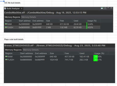

We are currently evaluating STM32H563ZI for a production system and would like your guidance on recommended CPU and RAM margin before moving to large-scale deployment.
Based on our current firmware build analysis (STM32CubeIDE Build Analyzer):
RAM:
Total: 640 KB
Used: ~182 KB (≈28.5%)
Free: ~458 KB
Flash:
Total: 1 MB
Used: ~282 KB (≈27.6%)
Free: ~742 KB
From a static memory usage perspective, sufficient margin is available. However, our application is load-dependent, and real CPU utilization varies based on field conditions and communication traffic.
