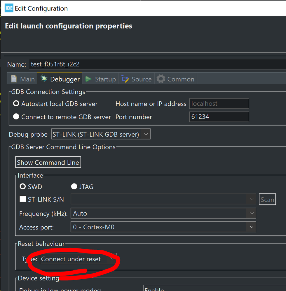

2022-03-10 6:41 AM
In CubeIDE, the setting is in the run/debug configuration options. TrueSTUDIO is NRND, but is probably similar.

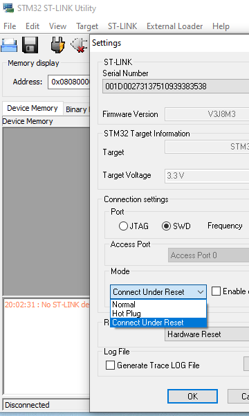

2022-03-13 11:06 AM
Maybe much simpler is to use the old good ST-Link utility to flash the update.
Configure it to connect under reset. It supports all STM32s known to Atollic.
