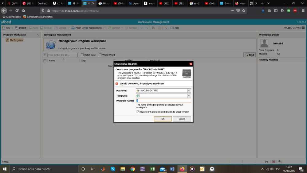

I am new to embed, I was trying to create a project today for my NUCLEO-G474RE in mbed using mbed but I got the following error:
Could someone please help me solve this invalid clone url: https://os.mbed.com error. Thanks in advance.

STM32G4 boards support is not yet planned in mbed.
In order to introduce a new target/STM32 family, you can have a look on the wiki page: https://os.mbed.com/teams/ST/wiki/steps-to-create-a-new-STM32-platform
Have a look to this discussion, it may help you.
Regards,
Imen
