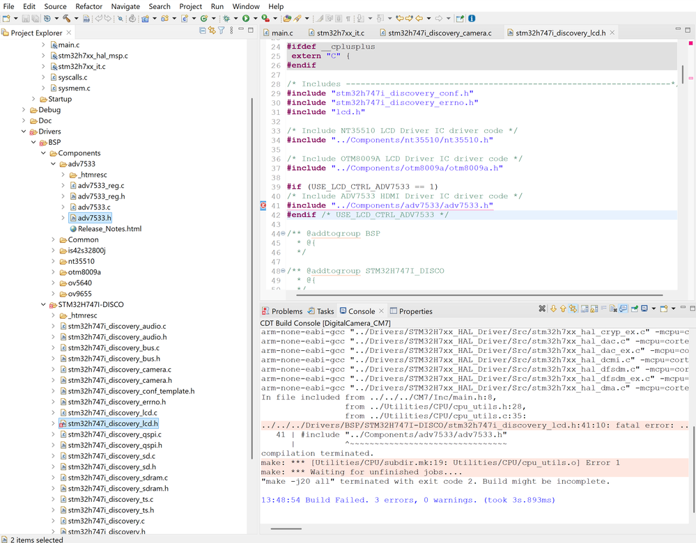

CubeIDE, STM32H747I-DISCO
For some reason my build keeps failing to find the adv7355.h even though the header is clearly in the project space & other headers with that path are found, see picture below. Anyone any clue why this is happening?

Hi I found the issue. For some reason (I know not what) I had another folder further up the hierarchy with the same name but with adv7355.h missing. All sorted now thanks.

Hello @NicRoberts;
Are you able to open adv7355.h from the project?
To check the issue could you please share your project?
