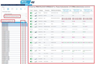

According to the part number you shared, this is what ST MCU Finder provided:
But you need to take care about some differences: TMS570LC4357 is a Cortex-R based microcontroller while STM32 is a Cortex-M based microcontroller, I/O number available on the package, are you suing Flex-ray or not,, the Flash Size ..
Need to use ST MCU Finder tool and make your study based on your specific needs.
