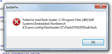

I want to use IAR Workbench 6.50.1.4452 for programming the device STM32F031C6T6. However, in the selection of devices, this series is not listed. May be because of that, the flashing has failed. (I am using the STM32F0 Discovery board for flashing.) Is it possible to add this device to IAR workbench? Or do I have to upgrade the software? What could be a workaround for this issue?2014-10-23 3:47 AM

Hi sandy.m,
You can use the attached patch as a workarround. Please install it under :C:\Program Files\IAR Systems\Embedded Workbench 6.5\.
the connection name isn't the correct one. But, you will be able to load and execute your application. To have the correct device name , an upgrade shoul be done. Best Regards, Nouha ________________ Attachments : arm.7z : https://st--c.eu10.content.force.com/sfc/dist/version/download/?oid=00Db0000000YtG6&ids=0680X000006HzXg&d=%2Fa%2F0X0000000bNM%2Ft1YKt.dnEPwdTYT1HxX2A_LWAlySoEuWrEUiSNi3LUo&asPdf=falseWe’re moving the ST Community to a new platform to give you a better and more reliable community experience.
