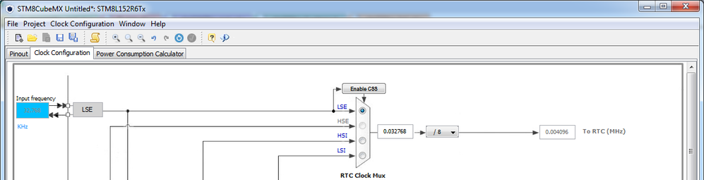

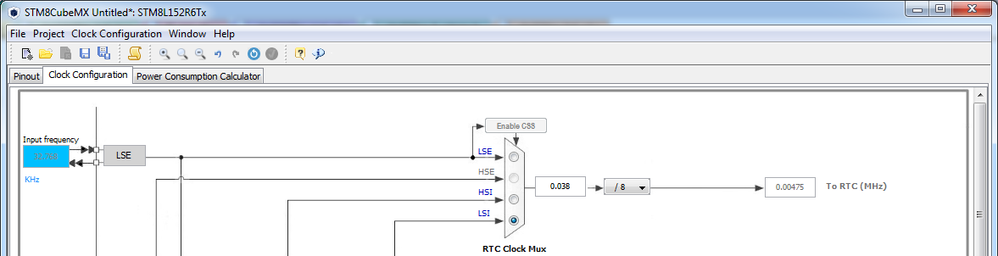

Anyway I created a new STM8CubeMX project for STM8L152R6Tx and I am able to select both LSE and LSI as a source of clock, that feeds RTC. Please see below:

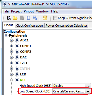

In order to be able to select LSE one thing in advance has to be done. In Pinout tab LSE has to be enabled (in RCC item):

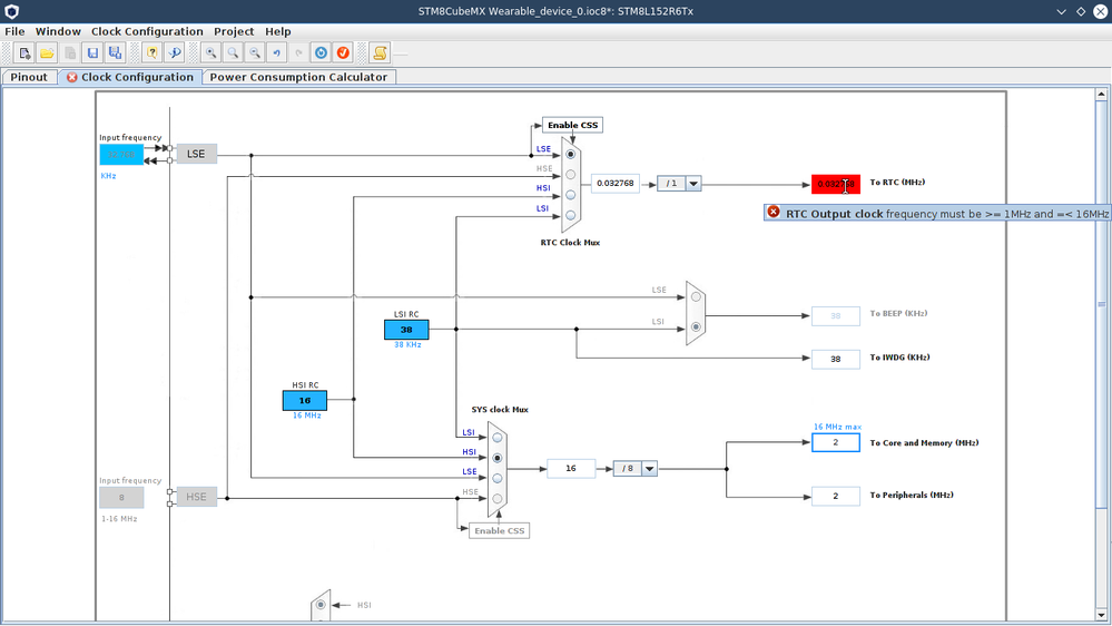

Dear Szymon, You understood correctly. I'm using Linux version 1.2.0, here is a screenshot.
Perhaps this is just a mistake in the program and to the restriction it has nothing to do. In version 1.3.0, the same limitation. What do you think?

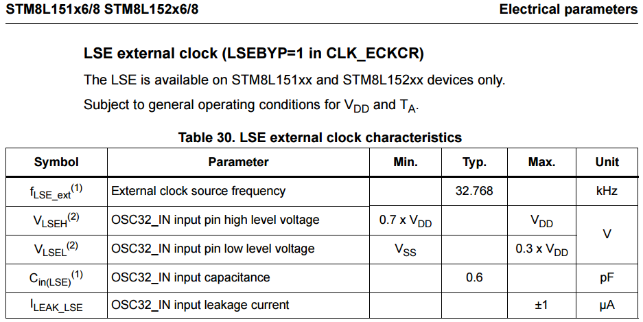

Thank you for clarification. It looks like a bug in the program. I am sorry for it, as I can imagine that it was confusing to you. I am sure you can use LSE to feed RTC and expected frequency of LSE is 32.768kHz. Definitely not 1..16MHz. As a confirmation of this information please find an extracted part from datasheet below:
