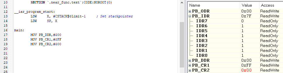

I was making a basic test for GPIO ports (reading switches and turning on LEDs). After configuring PORTB (all pins) as input with internal pull-up and external interrupts disabled, PB7 seems to be always in '0'. After opening IAR-EW debugger, PB_DDR, PB_CR1 and PB_CR2 registers have correct value (0x00, 0xFF, 0x00) but PB_IDR show (0x7F). This is, PORTB bit 7 is '0' (0111 1111).

I would check the schematics. You probably have a consumer with a lower impedance connected to the pin if you read a zero on the port input when the pull-up is active.
