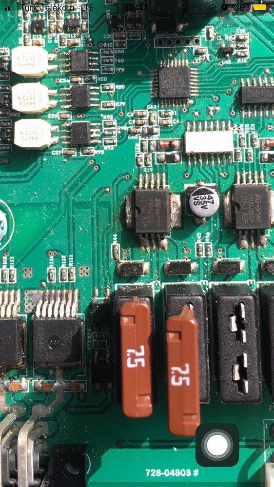

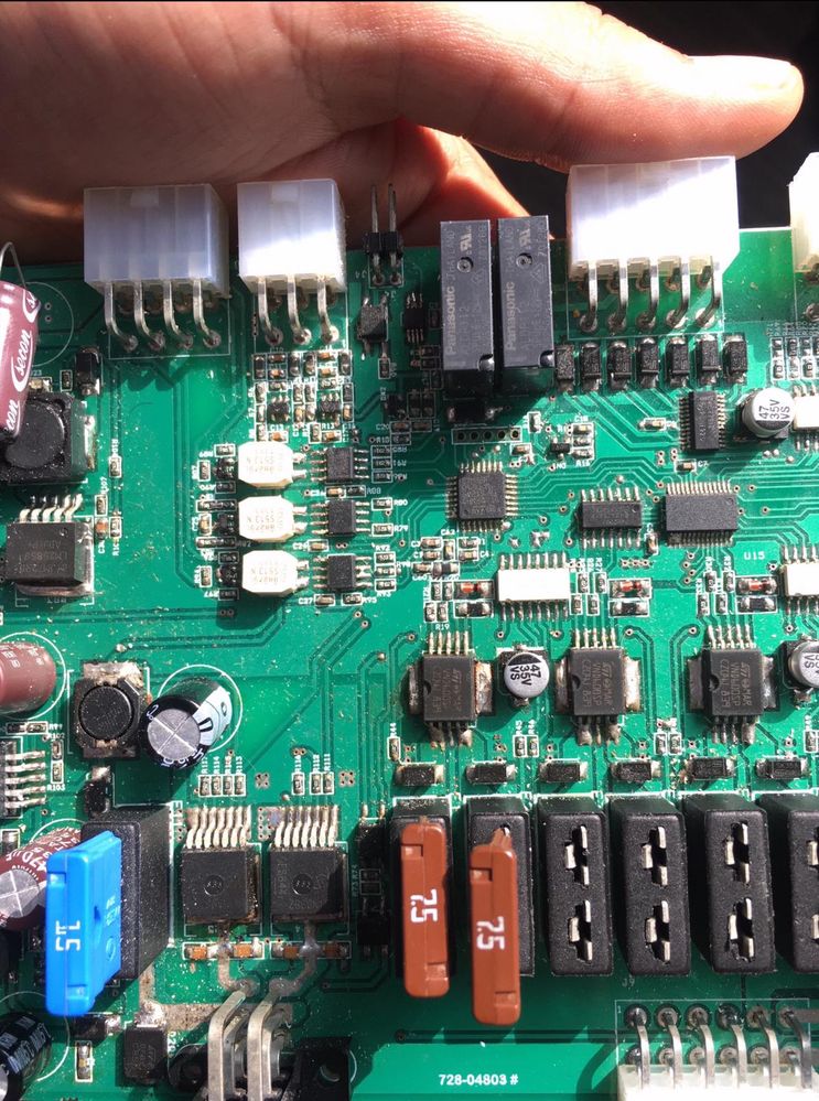

0693W0000059PtEQAU.jpg0693W0000059PtOQAU.jpg0693W0000059PtYQAU.jpgHi Peter,

At the first photos you can see the first and third dim level duty-cycle

The oscillogram doesn't look really good. The PWM frequency is 996Hz but it shows fairly flat edges which is a linear range and usually causes a lot of power dissipation which leads to the heating of the drivers.
How are the LED stripes internally connected (number of LEDs and current limitation)?
