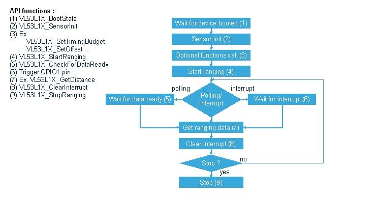

Before sending the FW used, based on the following flow:
I would like to briefly describe the defect found in the "VL53L1X_GetInterruptPolarity" function, called within "VL53L1X_CheckForDataReady", in turn called within "VL53L1X_SensorInit".

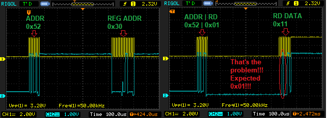

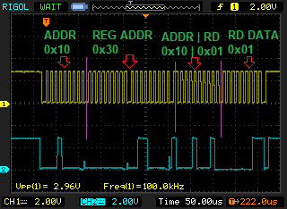

Comparing with the oscilloscope the I2C bytes exchanged in the working case of Arduino UNO and in the non-working case STM8S105, we have the following:
Comparing to Arduino UNO we expect to read the byte 0x01 from the register GPIO_HV_MUX__CTRL, but on STM8S105 we always read 0x11!!!
Due to this problem we have always been stuck inside the function without being able to receive any distance measurement data since dataReady == 0 ALWAYS TRUE !!! (data NEVER READY)
