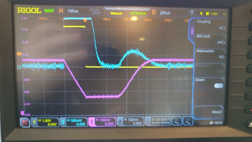

I have a system of photodiode and led to detect the presence of a substance.
I am producing 2 different 5V with SMPS for led and transimpedance amplifer.
my problem is that the led voltage sags while switching. and this sagging causes changes in the photodiode line, such as a camel hump.
I have to work with a small battery i don't want to power the led with LDO.CH1 led switch signal
CH2 Pd ADC input
CH3 led 5V supply
how do i get rid of this camel hump-looking voltage?
thanks

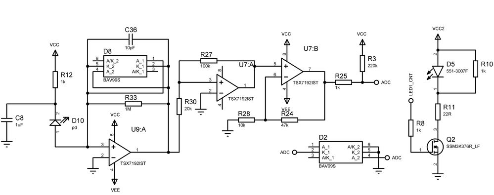

Could you share a drawing/schematic?
Where is your ADC connected to?
Why is the led 5v power supply dropping before the switching signal happens?
2021-11-05 2:09 AM
this is my circuit
1st channel LED1_CNT
2nd channel ADC
3rd channel VCC2
