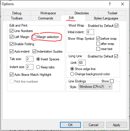

The STVD Editor's margin features are configurable. In the Tools >> Options >> Edit window uncheck the 'Margin selection' box in order to enable the setting of breakpoints. See the below screenshot and the STVD Manual section 2.7.1 'Customizing editor features'.

Thank you KMath.1, it works.
