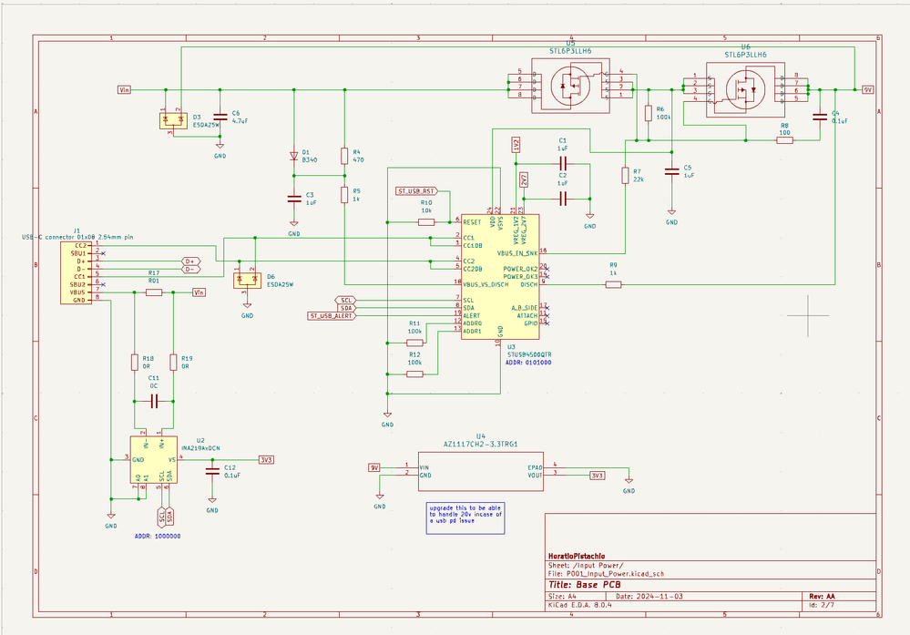

The STUSB4500 seems correctly supplied, indeed you measure 4.5V on VDD (= VBUS - voltage drop due to the MOS internal diode). Nevertheless, you should measure 2.7V and 1.2V at regulators outputs.
It could mean that the chipset is not well soldered or in reset mode. Can you check the level of RESET signal (even if its level should be the same as STUSB4500L...) ?

Thanks Didier,
I reworked the chip by covering it in flux and reflowing with a hot air gun. It now works the treat.
Thanks for your help :)
