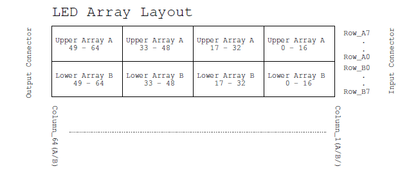

LED Connection and Panel Configuration
In my design, I am using the STP24DP05 LED driver to control RGB LEDs. Each output of the STP24DP05 is connected to the cathodes of 8 RGB LEDs (R1, G1, B1), while the anodes of these LEDs are controlled via 8 MOSFETs. The gate of each MOSFET is driven by a 3:8 decoder/demultiplexer, ensuring that only one row is active at a time.
Thus, with a single STP24DP05, I can control:
The full panel consists of 16 rows, where each multiplexer output controls 2 rows. The scanning mode is determined as:
Total rows÷Simultaneously active rows=16/2=8\text{Total rows} \div \text{Simultaneously active rows} = 16/2 = 8Total rows÷Simultaneously active rows=16/2=8
This results in a 1/8 scanning mode.
Each panel consists of:
For a 16 × 64 LED panel, I use:
Since the back panel has the same configuration, the total number of STP24DP05 drivers required for the entire display (front + back) is 32.
Note : As we are controlling LED anode switching using mux, at time only two rows will be on(one mux output is connected to two line).
Now can please relate my query above and share your feedback.
