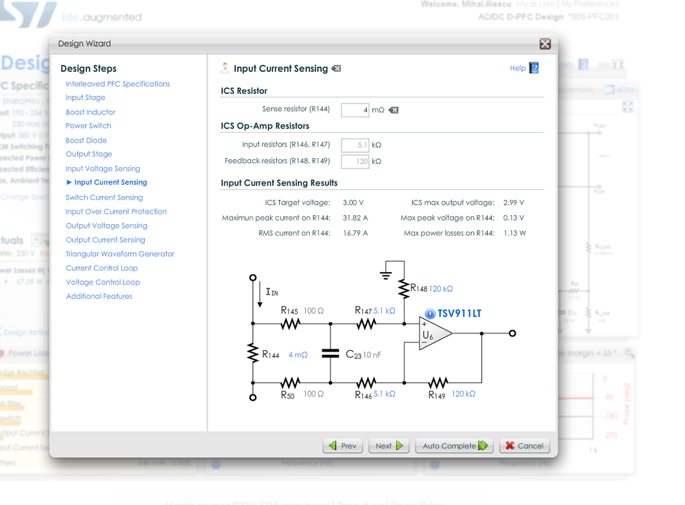

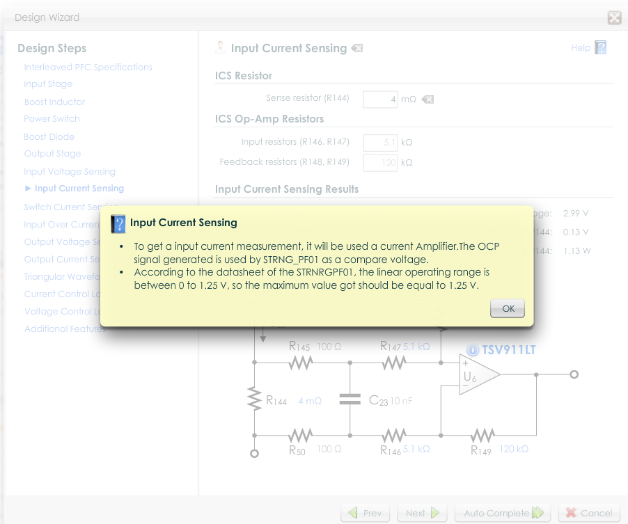

I found a problem in eDesignSuite when i try to use STNRGPF01 (PFC boost interleaved IC).
At input current sensing the ICS Target Voltage is 3.00V and in the datasheet the ICS Target Vltage looks like it is 1.25V (also in the Help section of eDesignSuite). Which one is correct?

In short 1.25V are a limitation on inside comparator present in this family products, as specified in pag 32 (table 14) of datasheet (https://www.st.com/resource/en/datasheet/stnrgpf01.pdf)
So every time user have necessity to compare a signal using internal comparator, the pin should have following range 0-1,25Volts.
This is the golden rule, in solution proposed, applied on
- Input Voltage Sensing Circuit,
- Output Voltage Sensing Circuit,
- Output Current Sensing Circuit,
where output go directly to a STNRGPF01's pin for comparision.
On the contrary on Input Current Sensing Circuit, the output of this module is a input for PI regulator so only in this case we can use a different target voltage according to the IC used in the Current Control Loop (https://www.st.com/resource/en/datasheet/lmv321.pdf).
The two resistors R58 and R62, between PI's output and OUT_PIN, give a scale factor of 0.635 that ensure the correct voltage on OUT_PIN pin.

The information on the "Help" is older and refers to the first version of the proposed solution, so please refer to the information in the ICS wizard.
Thank you for reporting, we will update this information on the next version, which should be released by 2018.

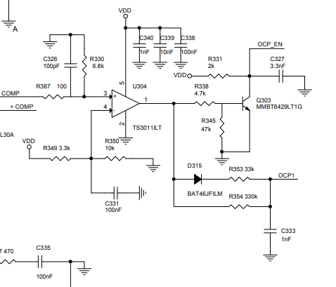

I got another question (i will use your link - https://www.st.com/resource/en/data_brief/steval-ipfc01v1.pdf for the schematic).
In the 4th page, where is the comparator circuit (U304) your negative input is ~ VDD(5V)*10k/(10k+3k3) = 3.75V. The input of the comparator is maximum 1.25V(-0.3 or -0.4 from the diode) so how it can ever switch?
On the design suite, the resistor divider it is correct.

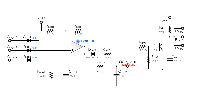

So, you have RocpL/(RocpL+RocpH) x VDD => 5*1.8/11.8 = 0.70V - that's correct.
So, i guess your board kit has a mistake?

The documentation present in website refers to STEVAL-IPFC01V1 where all OP Amplifier are supplied with 5V, so the input of U304 will be have a range from [0 - 4,7V].
eDesignSuite refers to a previous version of board where all OP Amplifier are supplied with 3V (EVAL-IPFC01V1).
In the future eDesignSuite will be updated to match with actual documentation of STEVAL-IPFC01V1.
Both designs are correct according to supply voltage selected for IC.
