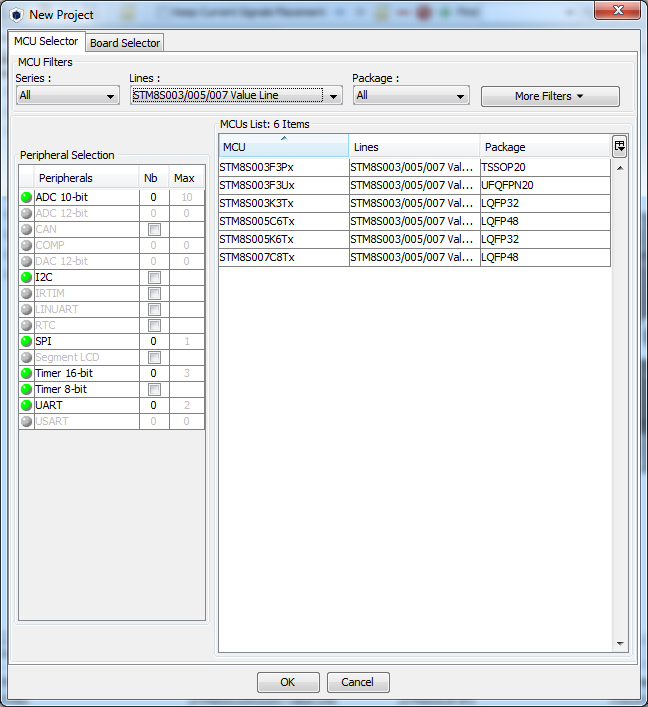

If you are particularly interested in STM8S Value Line MCUs, then in MCU selector please shrink the list of devices by applying the filter like on picure below:

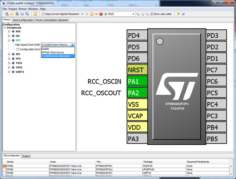

Once you select the device by double-clinking on it, you can check external crystal support by opening RCC item and by checking if there is an option named HSE: Crystal/Ceramic Resonator. With this approach you can see below that for example STM8S003F3Px supports external crystal.

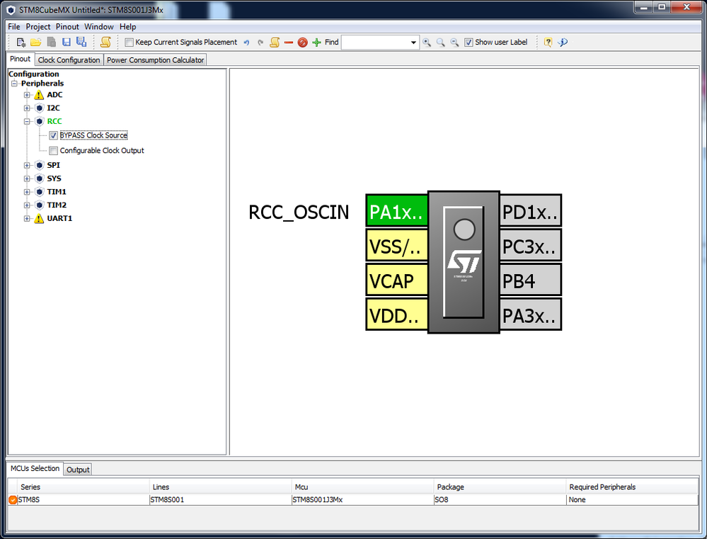

Regarding your question: all STM8S Value Line devices support external crystal except 8-pin STM8S001J3, which has only one input for external clock.
