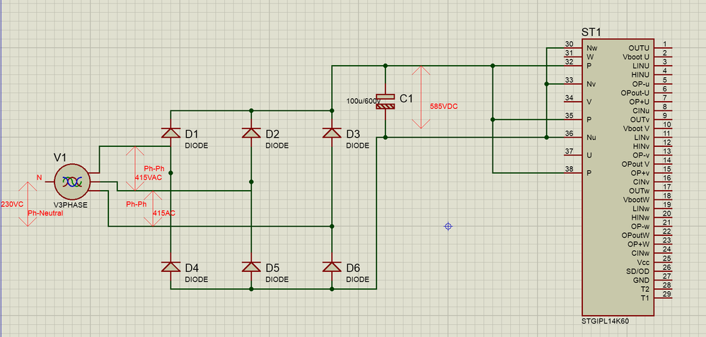

I bought STGIPL14K60 ..I want to rectify the 3 phase input. When i rectify it , I got about 585VDC.  Can i connect this high voltage to the MODULE or not. 0690X00000605dMQAQ.png

From what is stated in the datasheet of STGIPL14K60 you can't use it.
It is designed to work with 450 nominal up to 500 of surge voltage so 585 is out of specs.
