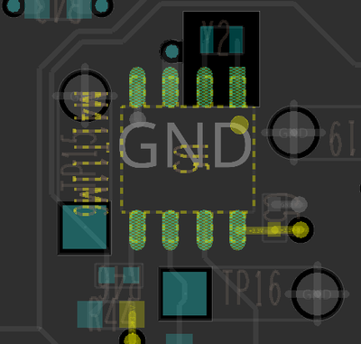

I’m currently having an issue w/ ST Micro P/N M4T11M6 RTC w/ clock drift. Specifically, I’ve performed verification testing on 4 units to this point and I’m seeing over 8 seconds/day (Extrapolating to a value of 4.25 minutes/month) of drift from NIST time. The RTC clock calibration register only allows for a maximum of -2.75 minutes/month which isn’t enough range to allow for the drift observed to be calibrated out. This makes me question my PCA schematic and perhaps layout design. The XTAL used meets the required 32.768 KHz XTAL w/ 12.5 pF load capacitance. I have cut-away the GND plane under the XTAL as well (However, it turns-out the +3.3V plane isn’t cut-away, but is in the middle of the 8 layer stack-up and the RTC and XTAL are on the top layer).

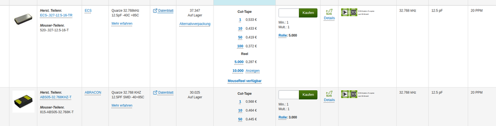

I'm using ST Micro P/N M41T11M6F which is the SOIC8. The datasheet specifically states that the load capacitances are integrated internal to the IC. For the XTAL, I'm using Citizen P/N CM1610H32768DZFT which is a 12.5pF 32.768 KHz XTAL meeting the specification requirements in the M41T11M6F datasheet. Do you know if the specified 35ppm tolerance in the M41T11M6F specification includes the XTAL or do I need to stack the PPM of the XTAL such that the total PPM will be 35PPM + XTAL PPM (20PPM for what I'm using) = 55 PPM??? Just trying to understand why I'm seeing > 8 seconds/day RTC drift. I've tested 4 PCAs and unpowered, I'm seeing 8.7, 8.1, 8.2, and 8.4 seconds/day drift. I've attached both the XTAL I'm using and the M41T11M6F datasheet I'm referencing on page 20.

No. I have NOT tried other XTALs. NOT because I don't want to, but XTALs all come in different package sizes and layout footprints, so it's impossible to take some new XTAL and place it into the board design. ST Micro doesn't offer a evaluation board for the M41T11M6F, so I'm stuck there as well. I did consider this, but there's no realistic way to put in a new XTAL w/o adding stray C,L from rework. It would take months to order a new board. Why do that when I can find a different RTC IC that has an evaluation board that I can do proof of concept with.

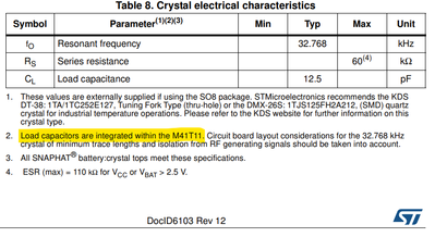

The too high frequency suggests crystal capacitance is too low. The data sheet Table 8 is ambiguous when it says in note 1 that capacitance is external for SOIC8, but note 3 says provided internally. And, @PeterBensch asks if you have external caps. Perhaps he can clarify.

I don't have external capacitors based on the datasheet information. Again, I'm using the SOIC8 package. The datasheet says that capacitors are externally supplied for the SO8 package. Also, the datasheet includes no information for calculating and populating a C1 & C2 external load capacitors. In my experience w/ NXP, ST MICRO MCUs, if load capacitors are required, there's a section on them w/ formulas provided for calculating the values and layout requirements, ect. This doesn't exist in the datasheet for the M41T11M6F, which also reenforces the idea that they're not needed as they're integrated within the IC so long as you're using a 12.5pF XTAL. I am using a 12.5pF XTAL. See my layout below. I have very little stray C as the XTAL is connected straight to the pins w/ close 4 mil traces.
If I solder in load caps as you suggest, to what GND would I attach on the right side? There's nothing there so I would need to add a lead wire and add additional stray C on one side vs the other.
