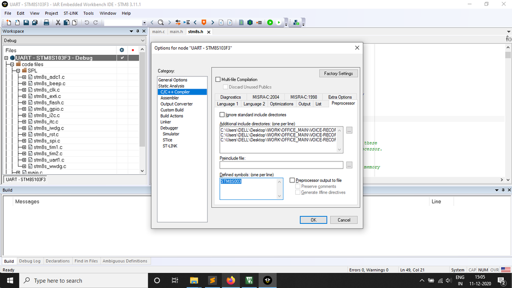

You don't need to uncomment or modify the libraries if you can add the definition in the preprocessor. But as I mentioned earlier, for an unknown reason, even adding the definition in the preprocessor wasn't good enough. 0693W000006FQ30QAG.png
You are right. Adding preprocessor definition works for me (using STVD and Cosmic).
