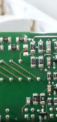

Does someones know what is the red devices in the board attached?
2024-03-05 7:47 AM
Those are spots of glue to keep the resistors from moving around when they are placing them. They serve no electrical purpose.

@TDK wrote:Those are spots of glue to keep the resistors from moving around .
doesn't seem to have worked in this case!
2024-03-05 8:04 AM
Likely the part was intentionally not loaded and the glue stencil wasn't modified. Also note solder paste on those pads--same reason.
2024-03-05 8:18 AM
so much tks
2024-03-05 8:21 AM
Assuming that's a No-Fit. It's also on the back of the board, so also stops them falling off, downward. Can see it behind the ones that were fitted.

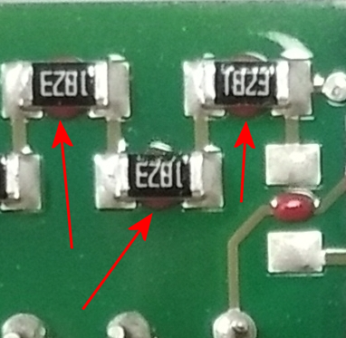

@SMusc.1 - don't forget to mark the solution!
BTW: If you look closely at the other components, you can see the glue under them, too:
