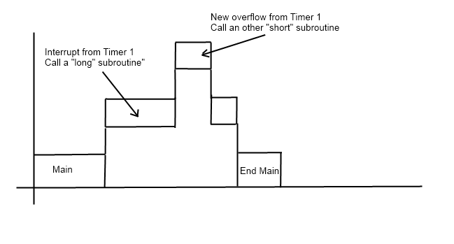

Is that an interrupt can be interrupted by the same interrupt (itself) ?

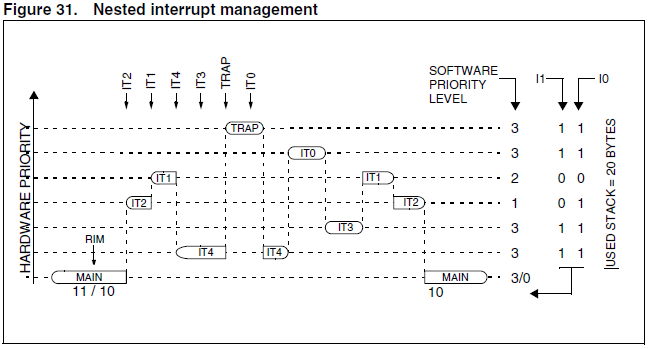

I know (according to the datasheet) that an interrupt can interrupt an other interrupt (in nested mode) :
But I wish to know if this kind of behavior is possible :
Associates code :
INTERRUPT_HANDLER(TIM1_UPD_OVF_TRG_COM_IRQHandler, 23)
         if(state == a) longTask();
         else shortTask();
I don't know if my question is obvious, if it does not, let me know and I'll try to explain better.

The answer to your question is YES: an interrupt handler can be interrupted by another interrupt handler and even by itself.
This behaviour is obtained when your interrupt handler enables interrupt within its body.
Please, be informed that you must be careful in doing this, because this action corrupts the stack if you doesn't clear the interrupt source flag before enabling interrupts again.
