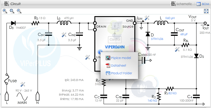

just today we have published a new release of eDesignSuite (7.8.0), where we added the possibility to download the PSpice model only for VIPer06, up to now.Open any buck design with this device, and click on the device name in the schematic. A menu will appear where you can download the PSpice model.2024-05-07 1:44 AM
