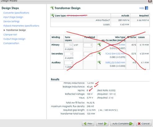

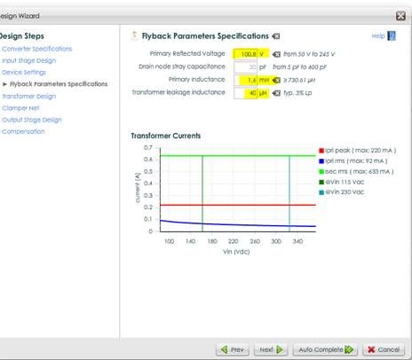

For your simulation in eDS you need the following parameters for the transformer:
From datasheet:
Main inductance: 1.6mH
Leakage inductance: ~40uH
Turns ratio Pri:Sec = 8:1 => reflected voltage = 8*12.6V=100.8V assuming a 0.6V drop voltage on the output diode.
Here are the steps though eDS that I went through:

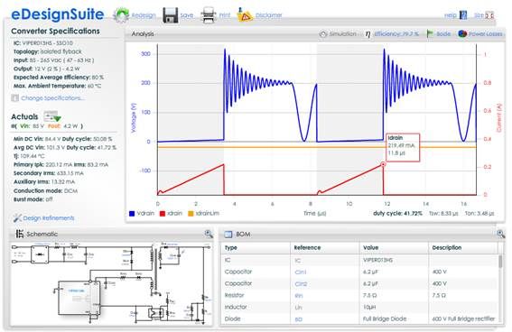

As you can see, for the simulation purposes, the transformer internal construction is not really needed as long as the transformer parameters are given along with the condition that peak current to be lower that the transformer saturation current:
