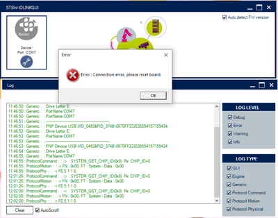

Hi, I am not able to connect P-NUCLEO-IOM01m1 to TEConcept tool as I have reprogrammed NUCLEO-F446RE with the downloaded program from ST website "en-st-sw-iom001" file. Before programming I am able to connect to the tool. After reprogramming it is not. I also used IOLINK GUI to detect the firmware version, LED test. Using this tool also not able to connect to device. I have taken snapshots of IOLINK GUI below are the images:
Please suggest suitable solution.

In DB3629, ST describes the IO-Link master "P-NUCLEO-IOM01M1" for evaluating the L6360 driver module, which consists of the STEVAL-IOM001V1 and the NUCLEO-F446RE board. Commissioning is described in the user manual UM2421. This document refers to a demo application from TEConcept. To access this application, one must create an account at TEConcept’s HP and then can download the software. The software consists of a demo app for Windows and the firmware for the Nucleo board. The firmware gets started by a special bootloader in the microprocessor's flash. The bootloader is located at address 0x08000000, but the actual firmware is in the high memory. If the bootloader is missing or this area gets overwritten, the software does not work anymore and the app reports "Can't connect to the master". Thus, the application is destroyed and cannot be repaired without help. For legal reasons, ST is not allowed to restore the bootloader and refers to an agreement with TEConcept. TEConcept in turn refers to the fact that ST is responsible for the support. Ridiculous! If partners do not cooperate, you should keep your hands off this project.
