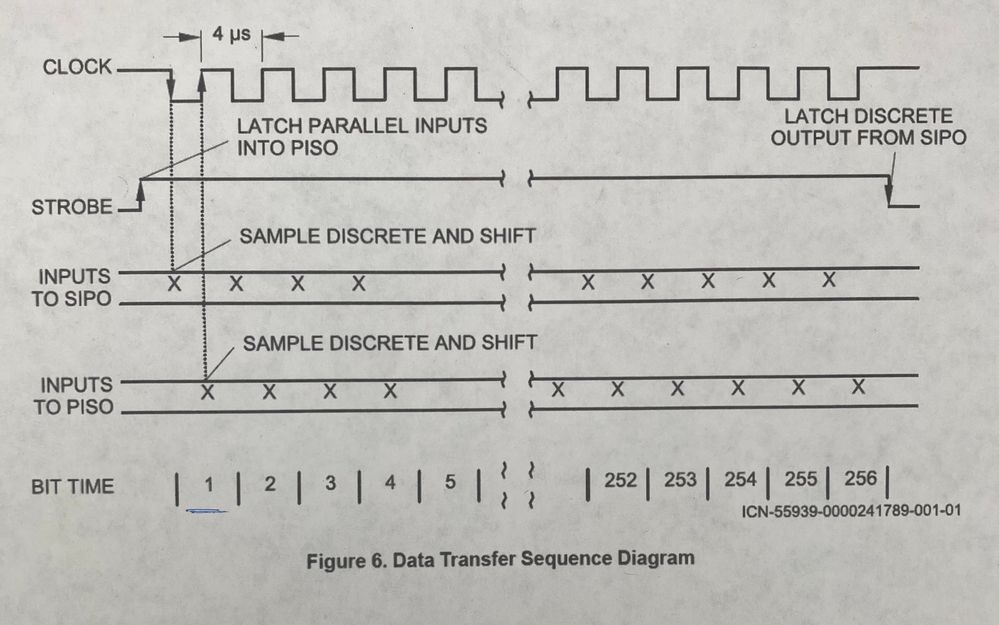

I have this Riverdi board (RVT50HQSNWC00) with a STM32U5A9NJH6Q MCU.
I want to programming data transmission according to the image attached
Im intent to use SPI but if any better option let me know
thanks in advance

I'm trying to make the signal that is show in the image, at first I was thinking to use SPI but now I'm convinced that is better to use RTC to do the intended job

WHAT device are you communicating with?
SPI at 250 KHz should be OK. Are you always sending 256 bits?
Would need to drive the Latch signal as a manual GPIO.

I’m trying to communicate with a Fly Guidance Controller of a private jet (Hawker 800). I’m fabricating a test bench for testing and troubleshooting that unit. I’m already test all the functions manually with an oscilloscope and a signal generator. But I’m want to automate the process. The unit transmit and receive 256 bites of data without any frame or crc. No start bit, nor stop bit, no data structure at all. This is common on this systems made by Collins for private Jets avionics. The unit uses RS422 levels and drivers but the data stream is created by logic gates arrays and not a single MCU. The unit is connected to the Fly Guidance Computer that as far as I know uses a FPGA to generate the data transmitted.
The three signals has to be synchronized. Every bit has an specific position on the data stream to activate a discrete output or input
sorry for the long explanation.
if you need to know more about the unit let me know.
