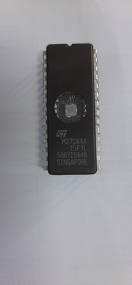

Thanks for your replies, this is the part. I have other parts with the L suffix   ??
Sorry without the L suffix !
I've seen too. I would look at the die size, bond wires, and ceramic / quartz housing, and production location. Could also relate to the lead frames, metal or tinning. Looking through materials here I couldn't see it called out across dozens of docs and data books.
Around this time ST, Intel and AMD all made very similar parts and had partnerships. There was always a strong push to shrink the die so more parts would fit on a wafer, so it was not unusual for the parts to change but retain form-and-function.
