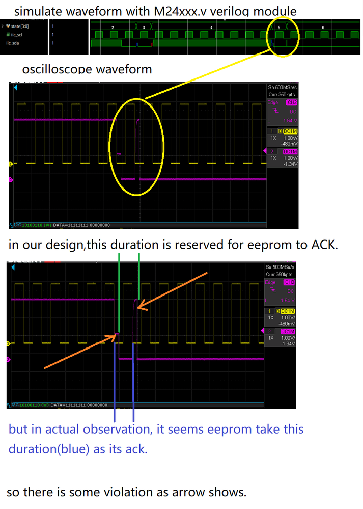

we are developing with ST M24C64-R EEPROM,and take FPGA chip as a IIC controller. we just
implement a byte write and Random Address Read for test. Both the simulation tool(with ST "M24XXX_Memory.v" verilog module) and oscilloscope wave shows that EEPROM ACK action is not totally matching our understanding.
We take a picture attached to illustrate. We want to know what is presice timing defination as "9th clock pulse period"?
We do not think it is proper to define a clock period at rising/falling edge of SCL(because it may trigger Start/Stop action). But it seems M24C64 EEPROM ACK at the falling edge of SCL.(?)
