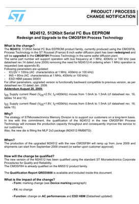

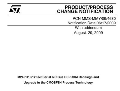

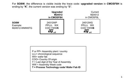

Dear @pepito60 , @Tesla DeLorean ,
Here you go , we sent A PCN to our customers  in 2009 on the difference with an upgraded design.
Let me know if it helps. and sincerely sorry for the experience you had . Merci depuis Paris :) Metro
Ciao,
STOne-32
