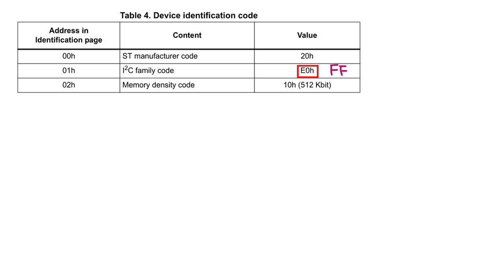

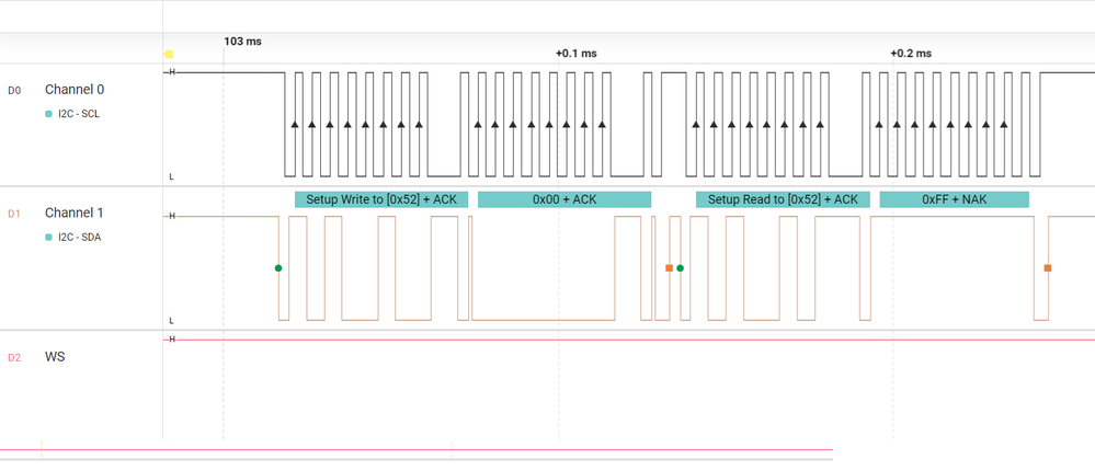

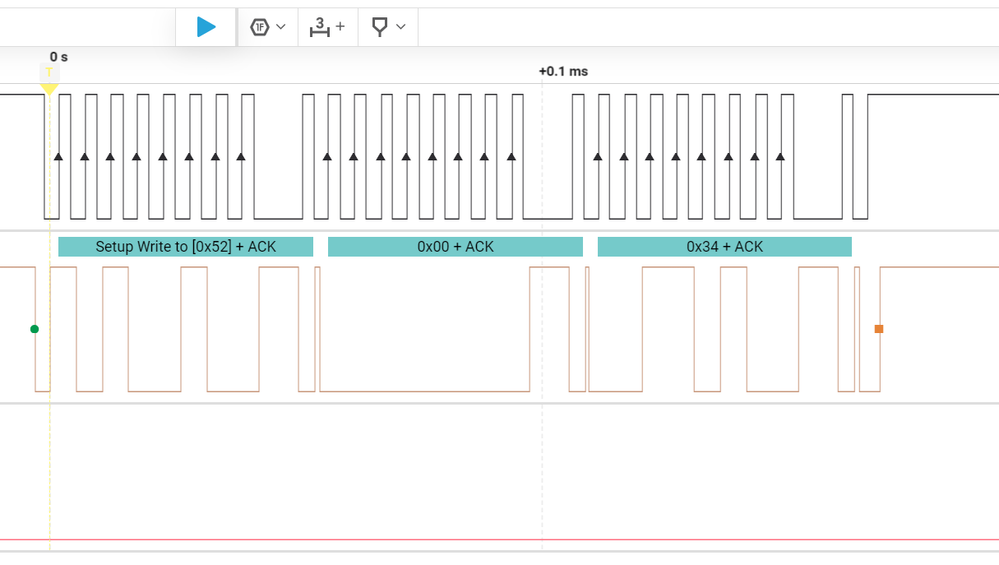

I intended to write a wrapper to access the memory section of the M24512 part. I began with enumeration using the device identification code, but instead of receiving I2C Family as 0xE0, I got 0xFF, I need to understand what went wrong. Additionally, when I write a byte to memory and read it back, it still shows 0xFF, please find trace logs attached, appreciate your quick reply.Read-Byte.pngWrite-Byte.pngWrong-Family-Code.png

I realized my mistake, was using 8bit address and data, not 16bit as expected....!!! Please mark it as done, Thanks
But still the Family ID is wrong...!!!
