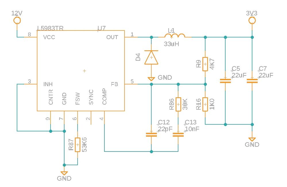

I have a circuit with 2 L5983TR on it. On his generating a 3.3V supply the other 1.2V. 1.2V supply is fine, but the 3.3V supply is switching off. Circuit was generated using DesignSuite, and I have changed pretty much every component but to no avail. Current draw is about 200mA. Time for the scope trace is about 10 seconds.

From the schematic we can't understand if it can be a problem due to an incorrect layout or if the regulator reaches the current limit.
Please, be sure that:
Let us know if all these conditions are verified, so in case we can go in a deeper analysis.
