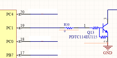

2023-01-10 1:30 AM
Thanks for your help.
Sorry for my poor explaination, what I mean is something tlike this:

2023-01-11 12:51 AM
Oops, sorry, I got it mixed up with the STM8S family library.
You are right, of course, but you should take into account that on the STM8L051 exactly two pins are so-called true open drain ports - PC0 and PC1. The RM0031 writes about this:
In the true open-drain I/Os, P-Buffer, weak pull-up and protection diode to VDD is not implemented.
This means: to drive an H-level at the output, you must connect an external pull-up, which provides the driving current for your npn BRT.
