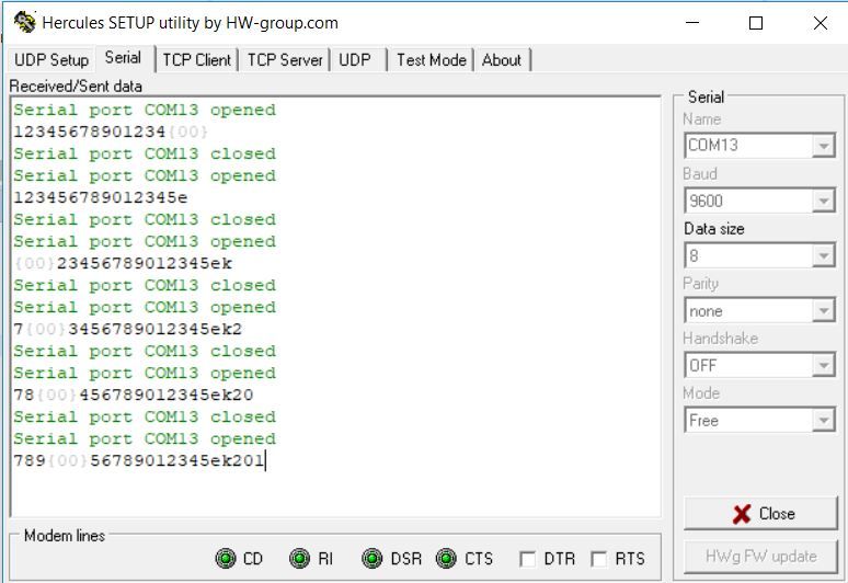

I have a problem with I2C eeprom 24LC16b and also with 24LC65. Altough the internal buffer is 16 bytes I can sent at once only 15 bytes (14 characters + 1 null char) and the same is aslo for 24LC65 (Instead of 64 I can store only 63 chars at once = 62 chars + 1 null char).
I use HAL drivers. All the initialization code is created by CubeMX. I tried with internall pull ups and also with external 4.7K pul-ups.
Bellow is a snippet from my code inside main function.
Bellow is also a screenshot from my serial (UART) program, where you can see results readed from my EEPROM 24LC16b when I store "12345678901234", "123456789012345", "1234567890123456". "12345678901234567", "123456789012345678", "1234567890123456789" respectively.
We can see that when the length of the string is greater than 16 chars remaining characters go to the begining of the EEPROM buffer. That seems OK but where does go character 16 (second output bellow) - buffer is 16 bytes long)!? When I used 24LC65 the same occours after 64 character but character 64 is missing as it was for output 2 bellow).
Look at the last picture bellow (outputs). The first output is OK (we can also see the last null character). In the 3rd output (I store 17 chars into eeprom) null character rotate to the first location and owerwrite 1 (that's OK), but where did null go in the 2nd output. When I store 16 characters the last character e (and other last characters from later outputs where I store more than 16 characters) wasn't written by our program => so it is something old data from the memory; that's also OK).
Thanks for help!

Results:

The problem is solved!
24LC16b needs only 1 byte length of EEPROM memory location address (some eeproms has 2 bytes or WORD memory addresses) that is combined with 3 less significant bits of a device address B0, B1, B2. These bits are used to address eight 256 bytes memory block. And inside this memory block address byte is used to address individual byte location inside.
So I just replaced this line of code:
HAL_I2C_Mem_Write(&hi2c2, i2cAddress, MemAddress, I2C_MEMADD_SIZE_16BIT, (uint8_t*)writeStr,strlen(writeStr)+1, HAL_MAX_DELAY);
with this (sent only 1 byte of memory address):
HAL_I2C_Mem_Write(&hi2c2, i2cAddress, MemAddress, I2C_MEMADD_SIZE_8BIT, (uint8_t*)writeStr,strlen(writeStr)+1, HAL_MAX_DELAY);
The same change I made also for receiving data from EEPROM and it works as it should.

The page size for 24LC16b is 16 bytes (the same as the size of its buffer in this case). Because I write 16 bytes starting from memory address 0 I don't cross the page.
You metnioned: "Bury these delicate specific code in a generic function with ...". The problem is that my code doesn't work corectly for trivial "school" cases. It doesn't store 16th byte. Why? But if I sent 17 bytes, you can see that the first byte (number 1) is overwritten with a null character as it should be and the 16th bytes also is missing.
If the entered and read strings matches the test LED turns ON (it works for strings shorter than 16 bytes), but it doesn't for string of 16 bytes and of course (that's normal) for longer (this mismatch also shows the UART).
I read the datashett for 24lc16b many times and I can't see the problem. It might be the problem with HAL functions for I2C or I missed something, I don't know?
