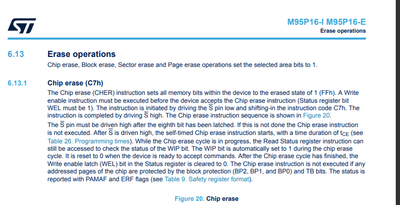

You have to find the datasheet for your EEPROM chip and find the Erase Operation command, so in your microcontroller you can send it.
For example, you check in your eeprom for a value that must be FF, if it is not FF, you clean the EEPROM.
Hope it helps.
