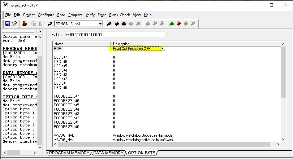

I do not have that mcu or its datasheet at hand but have a look in the datasheet, search for Read Out Protection. You can set it with the ST_Visual_Programmer (or during programming the code).0693W00000AMiyxQAD.jpg

Hello WilkoL ! Thanks for your answer. But If I can do this with ST Visual Programmer, someone who have my product can do the same no? and turn off this byte?
WilkoL
Senior
Yes, and end up with a nice clean (empty) mcu.
