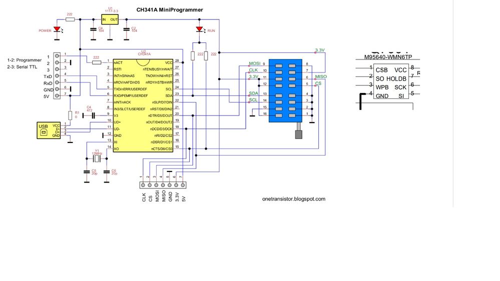

Can I program M95640WP using CH341A Programmer

2020-08-24 10:34 AM
Seems when you rotate memory IC and place it to upper 8 pin in programmer, then connection will be ok.
Next step is sw setup....
2020-08-25 7:02 AM
thanks for the suggestion.
I was also thinking the same way but, surprised to see that on reversing the IC the programmer's 7th & 8th point (11 & 12) both having 3.3V
2020-08-25 10:42 AM
Pin HOLD is too connected to Vcc then no problem here, i mean bigger step will sw .
