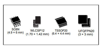

STM32C0 family has lowest packages sizes.
Example: STM32C011. Refer to the datasheet:
and reference manual: RM0490
C0 family is intended to replace 8-bit MCUs.
Use STM32 MCU Finder tool to fine tune your selection.
