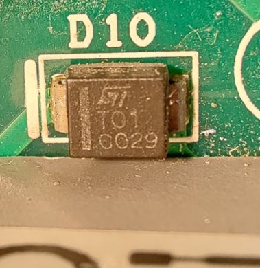

I have a couple of diodes that needs replacing, but I can't decode the markings.
Is there a reference manual or an easy way to find the right diode?
The markings are:
ST-logo
T01
C029
Can anyone help?
Thanks!
Elco

mƎALLEm
https://www.st.com/resource/en/datasheet/stpst1h100.pdf
3 REPLIES 3
EZHON.1
which board do you have? you can search the schematic and BOM based on your board reference MBxxxx.
mƎALLEm
Thank you very much for the quick and correct reply!!!
