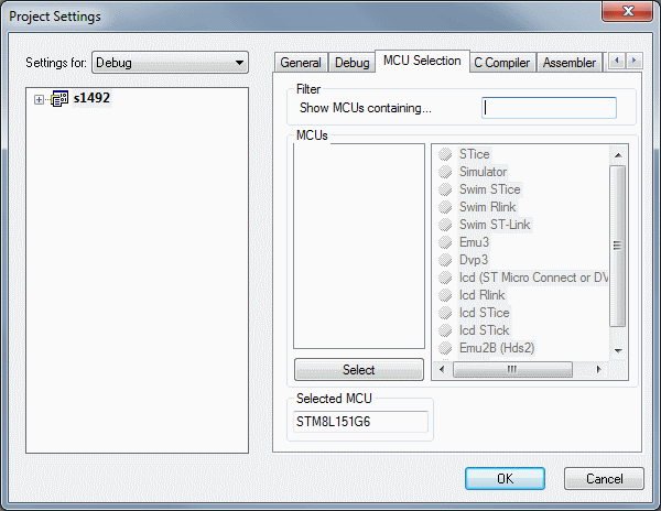

I need to a Debug an STM8L151 with ST Visual Develop, I have the cosmic compiler installed and activated.
My Project builds, but wont start debuging.I get the warning/error ''Before running the application, you should first select a MCU for the project''Going to the project settings, it wont let me select any MCU, i've got an empty list. On another PC this list is populated.Have tried uninstalling and reinstall the compiler and ide multiple times.2014-04-17 5:06 AM

Ran the .msi installer but it hasn't helped. any other ideas?I get a similar error when creating a new project, I get a window asking to select an MCU for the project with no MCUs listed the OK button is greyed out and the window has no close or cancel button the only option is to kill the process.Carl.2014-04-24 1:33 AM
